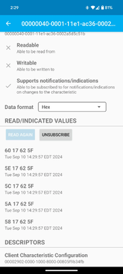

I've used the ST BLE sensor app to set the device to stream compass data, I used the included example and did not change anything. In the app, I can receive compass data without a problem with its included visualiser. I then used the Lightblue app to receive the same data, and it worked without a problem. I used the BlueST datasheet to figure out which characteristic held the compass data, and subscribing to receive notifications worked immediately.
