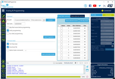

click the second icon, browse the BLEFOTA_BL_1.0.0.bin file in the FOTA folder (https://www.st.com/en/embedded-software/stsw-mksbox1-bl.html) and set all parameters as in the picture below:
4. start program
4. start program
