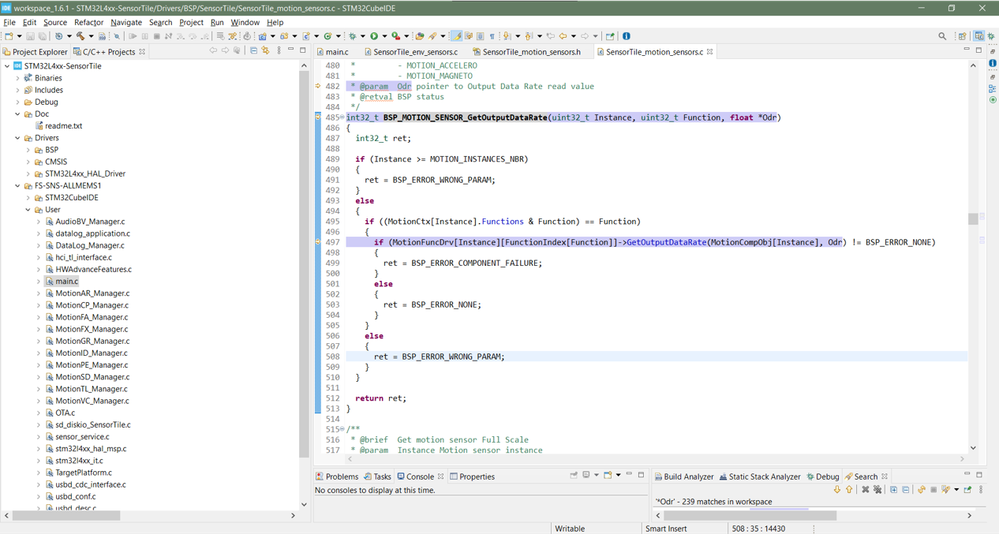

Thank you for your reply. I'm sorry but I'm new to programming. This is the screen of my program, but i didn't understand where i have to enter the sampling frequency i would like.
I would be happy if you could help me, thank you.

Hi Chiara @CRoma.1​ ,
I'm sorry, I answered without asking how much do you know about microcontroller programming =)
let's start from scratch: which application of the ALL_MEMS1 firmware are you using?
I mean the one you want to change the ODR of the sensors.
Niccolò
