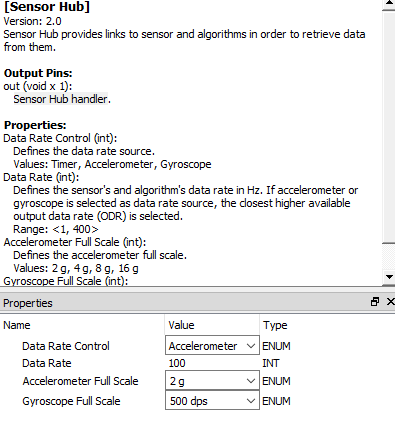

Eleon,
After trying to understand the architecture, i realized that the ACC ODR is maybe well set and i juste need to change the timestamp data for data at 10ms Frequency. Actually it work aroud 1 data each 50ms. I have trying to do this with algobuilder and it work fine. In my csv file a have 10ms timestamp
but now i want to do it with Bluetooth Project ALLMEMS1, but dont found the data to modify....
I hope to be clear in my explaination
Thanks

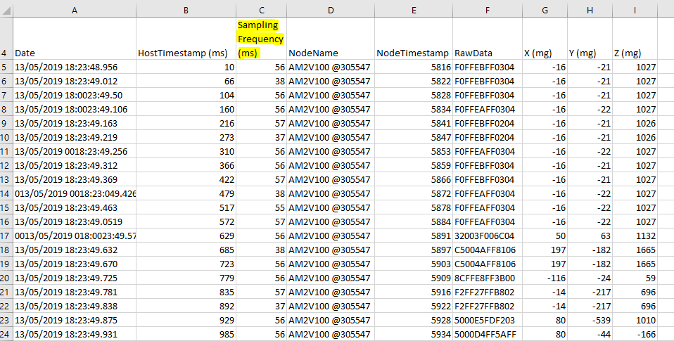

2019-05-13 9:47 AM
Hello Eleon, thank you for your help
I found all the data your show in your answer, and this remains a mystery to me because, since the ODR is actually well set to 100.4f, my samling data still represents 50ms sampling period.
I collect data with Android APP and Unicleo and it's the same sampling period !!!
I have taken a screenshot of my CSV values , I will be very grateful to lighting me. Thanks a new time for your help
