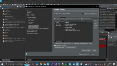

The first problem I encountered is that the defined variable "STM32L4xx" seems not exist so I have to add it manually into the path and symbol property:

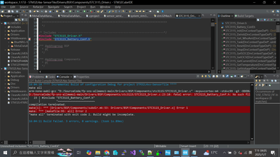

However, I encountered another problem that the header file "STC3115_Battery_Conf.h" is not exist:
I am completely stuck at this point since I cannot find it anywhere even in the Github....

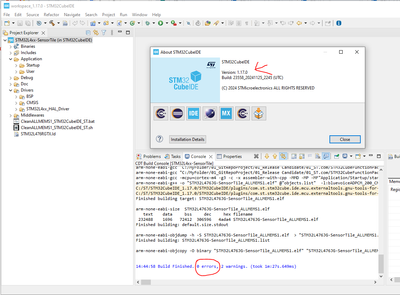

the latest version of the package FP-SNS-ALLMEMS1 that support the SensorTile (STEVAL-STLKT01) board is 4.2.0 (the latest version of the package is 4.3.0).
I downloaded the version 4.2.0 from https://www.st.com/en/embedded-software/fp-sns-allmems1.html, I open the STM32CubeIDE project using the version 1.17.0 of the tool, I build the project and I do not see any problem (see the image below or attachment)
The warnings are known and referred in the readme and in the release note.
