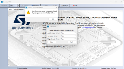

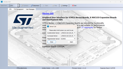

I open up the Unicleo-GUI and am met with the following...
So far so good, the board & its sensors have been recognized and that's the same sensors I added in the software component section
I click apply & ...
What am I missing here? I've stepped through the document a few times now but cant for the life of me find what's missing

2025-01-17 4:54 AM
Please try to switch io_ctx.Address from LSM6DSO16IS_I2C_ADD_H to LSM6DSO16IS_I2C_ADD_L in LSM6DSO16IS_0_Probe() function in custom_ispu_motion_sensors.c file. There is ISM330DHCX sensor on IKS02A1 board which has the same I2C address as your LSM6DSO16IS in DIL24 and to distinguish between them the onboard sensors have I2C address LSB bit connected to VDD while DIL24 ones to GND.
