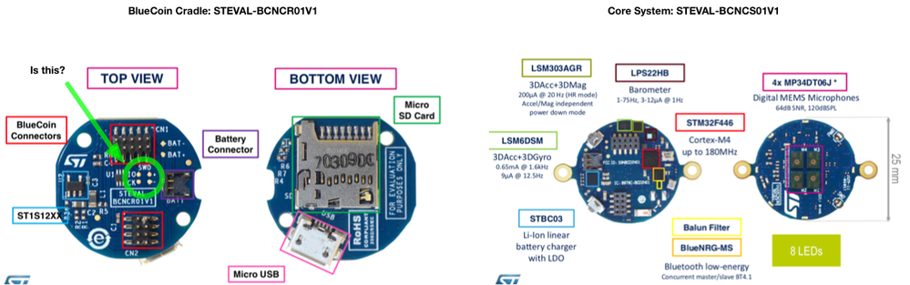

Hi @Eleon BORLINI ,
Therefore should I buy and solder the one FTSH-105-03-L-DV connector (not provided) and one cable to connect the board to the ST-link on the nucleo?
If yes, can you provide the part number of the FTSH-105-03-L-DV female connector in order to make a cable out of it and reach the nucleo? I'm not able to find a 4 pins samtec connector.
In the picture the connector position is highlighted in green.
Thanks
2020-10-22 2:08 AM
Hi @frnt ,
yes, it is the green circled area. I would have directly wired the exposed pads on the cradle, directly soldering 4 wires on them... I how this is a "patch" solution, but you always can use short wires and then plug extensions on them.
But ok, the female cable for the FTSH connector could be a standard ribbon cable. Please be sure that it is not too high and fits the available space.
-Eleon
