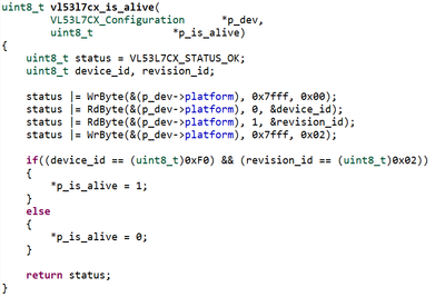

Hi
Seems something went wrong during your test, as you mentioned, you can run with L7CX CubeIDE example, I pasted the code below, actually the function is nearly same as you showed for LMZ, there are two reg reading, for L7 the device_id is 0xF0, and revision_id is 0x02. if L7CX can pass, the LMZ should be able to pass the device check.
"To make sure X-NUCLEO-53L7A1 works, I tested it with a simple ranging example found in CubeMX and it worked."
Br
Zhiyuan.Han
