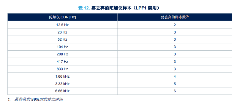

Question 2: In the Chinese version of the ASM330LHH User Manual, Table 8. Accelerometer Samples to Discard, Table 12. Gyroscope Samples to Discard (LPF1 Disabled) and other tables all mention the term "number of samples to discard". What does this mean? How should I handle this—does it need to be implemented in the design, or just noted during usage?
