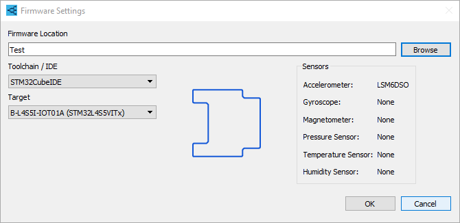

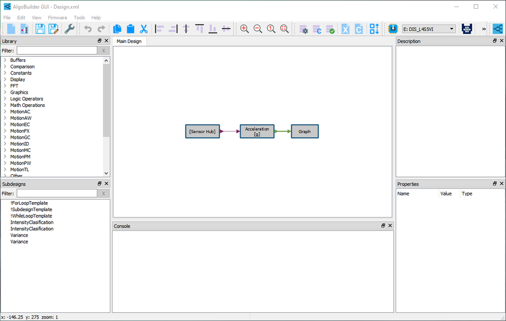

I'm having trouble setting correctly AlgoBuild and MEMS1 in STM32CubeIDE, in order to use Algobuilder, Unicleo, and Unico to recover data via the accelerometer and create IA algos.
Here are my Algobuild and MEMS1 settings.
0693W000008zyObQAI.png0693W000008zyOgQAI.png0693W000008zyPKQAY.png0693W000008zyORQAY.png
When I compile the project, there are some minor errors, that can be easily resolved by manually including the missing files.
Then, I copy the repertory where my project is, in Users\user\STMicroelectronics\AlgoBuilder\FirmwareTemplate so my firmware is recognized by AlgoBuilder.
Generating and compiling the Firmware gives no error, neither when I program the MCU. My main problem arrives when I try to use Unicleo, it tells me that it can't recognize any boards connected to my computer. I have checked the setting option to list all COM ports, but that doesn't resolve anything; I can now see the COM port where my board is, but when I select connect, the option to Start doesn't become available.
