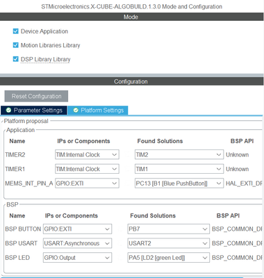

First problem was that your timers should be switched, TIMER2 have to support Capture Compare functionality and you have the timer with this functionality (TIM1) in TIMER1 (I understand that it was logical choice to use TIM1 as TIMER1 but...).

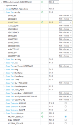

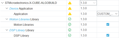

- For the algobuilder Software pack i selected this (the warning goes off later on when i select the MEMS custom motion sensor):
- For the MEMS Software pack i selected this (to make everything easier for starters i selected only the Steval sensor):

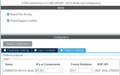

The algobuilder pack configuration is as shown below:
and the MEMS is this one (everything on I2C1):

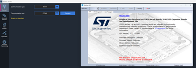

If i run the code using the CubeIDE and try to connect the board i get this error (im tying now with MEMS Studio too):
(I know there are no sensor data, but it should at least display the sensor available, am i wrong?)

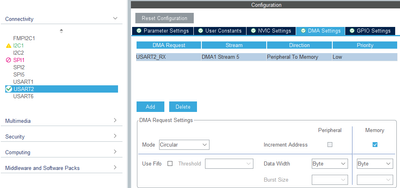

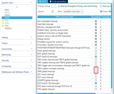

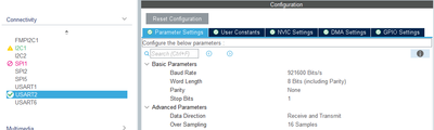

I also enabled usart nvic
By the way, i want to use the LSM6DSOX sensor instead of the LSM6DSO so, is it an option to add that sensor and set it to GND instead of the DIL24?

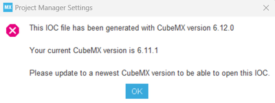

What versions of STM32CubeMX and STM32CubeIDE do you use? Please try latest CubeMX v6.11.1 and CubeIDE v1.15.1. I have slightly modified the ioc file in terms of GPIO pullups, project and code generator settings. It compiles well on my side, I just didn't test it in MEMS Studio on HW.
2024-05-16 2:39 AM
Im using the latest versions released, but the .ioc you provided me doesn't open, it gives an error about being made on CubeMX version 6.12.0
