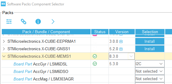

I'm having trouble setting correctly AlgoBuild and MEMS1 in STM32CubeIDE, in order to use Algobuilder, Unicleo, and Unico to recover data via the accelerometer and create IA algos.

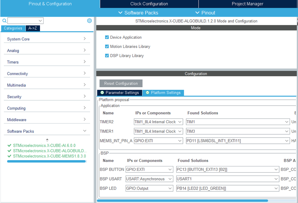

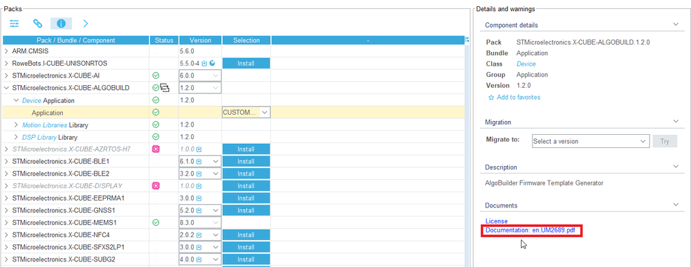

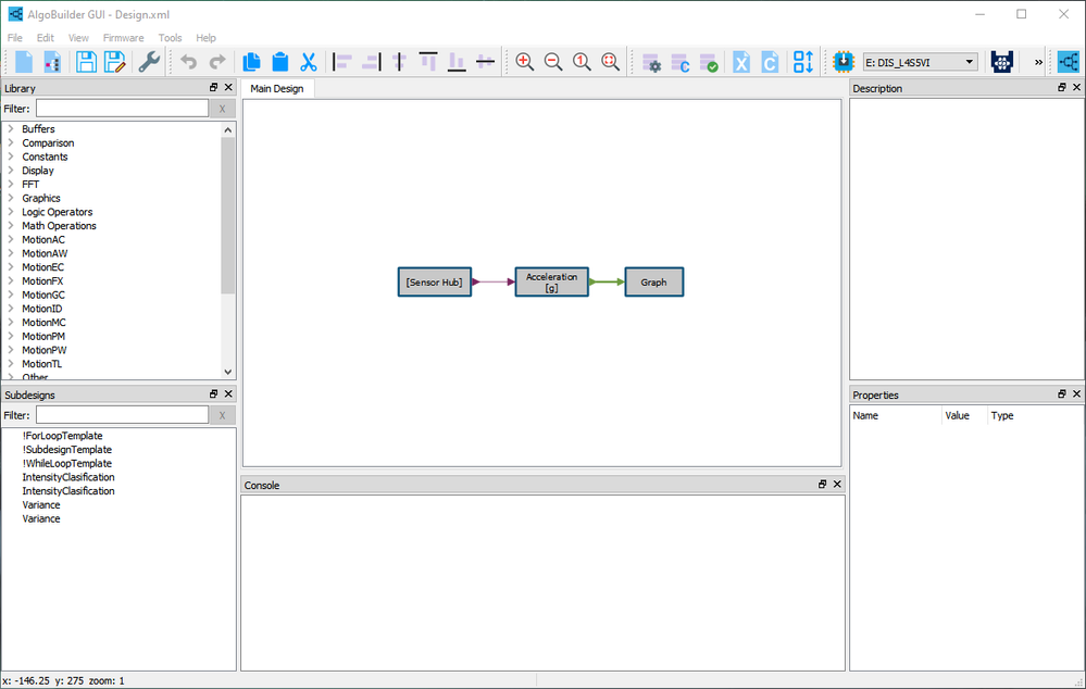

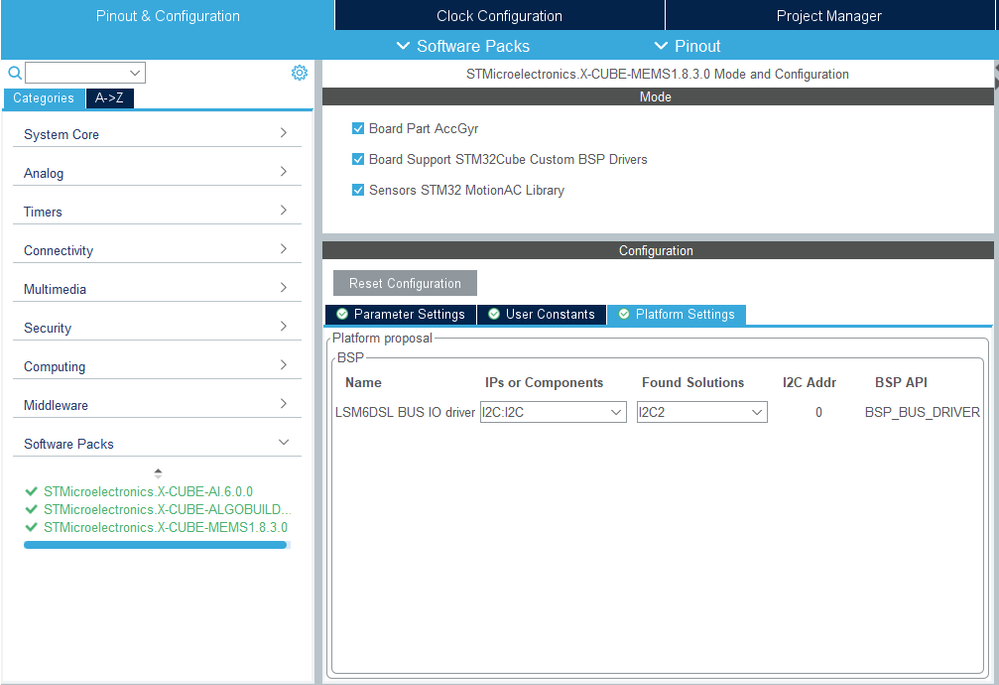

Here are my Algobuild and MEMS1 settings.
0693W000008zyObQAI.png0693W000008zyOgQAI.png0693W000008zyPKQAY.png0693W000008zyORQAY.png

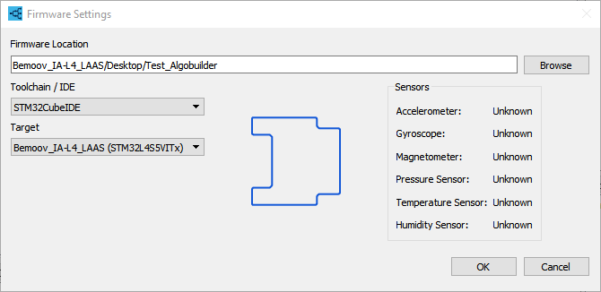

Then, I copy the repertory where my project is, in Users\user\STMicroelectronics\AlgoBuilder\FirmwareTemplate so my firmware is recognized by AlgoBuilder.

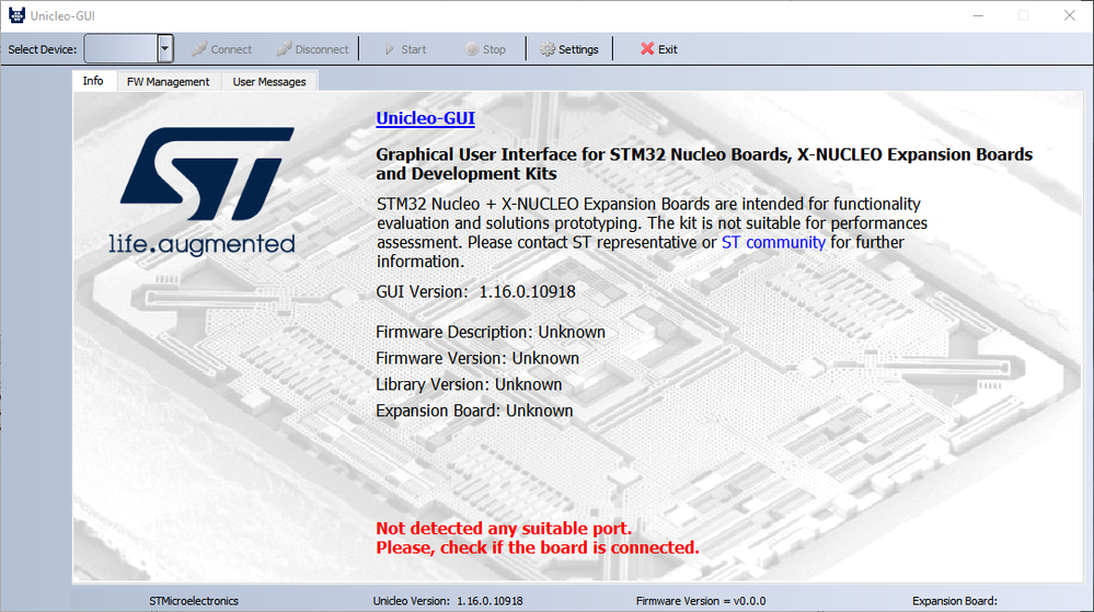

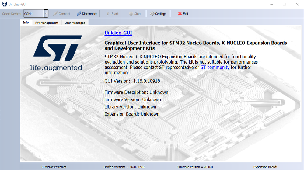

Generating and compiling the Firmware gives no error, neither when I program the MCU. My main problem arrives when I try to use Unicleo, it tells me that it can't recognize any boards connected to my computer. I have checked the setting option to list all COM ports, but that doesn't resolve anything; I can now see the COM port where my board is, but when I select connect, the option to Start doesn't become available.

I checked with out experts, and they told me that the firmware generated by AlgoBuilder use the proper communication protocol so the Unicleo-GUI doesn’t need to know the board.
The problem could be in the so called firmware template generated in STM32CubeMX (using X-CUBE-ALGOBUILD and X-CUBE-MEMS1). Can you please share this firmware template for a check? Maybe some settings is not correct.

Thank you for your reply. Here are the screenshots of the configurations that I use in CubeMX and the generated files as well. Please let me know if you need anything more.
 0693W00000AM58xQAD.png0693W00000AM58iQAD.pngEli A.
thank you for sharing the files but I would need the complete directory or the ioc file to be able check your configuration.

I would propose following:

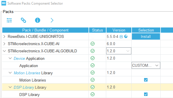

  • remove X-CUBE-AI components (at least temporarily)
  • check settings of peripherals required by X-CUBE-ALGOBUILD (you can check the UM2689)
At first glance I see following problems:
  • I see the UART has wrong baud rate, missing DMA configuration
  • You should enable Capture Compare interrupt for TIM1 in NVIC

  • Disabled the X-CUBE-AI module
Do I need to see any changes in Algobuilder when I look for my Firmware and Target? Because all my sensors are Unknown.
Eli A.
Hi Eli,
the settings seems to be OK, but I still see the X-CUBE-AI in the project. Could you please remove it?
It is OK to see Unknown instead of the names of the sensors, this information is loaded from capabilities.xml file but so far the file must be added and modified manually.

I thought that I have it disabled, but here is the project without the AI module.
