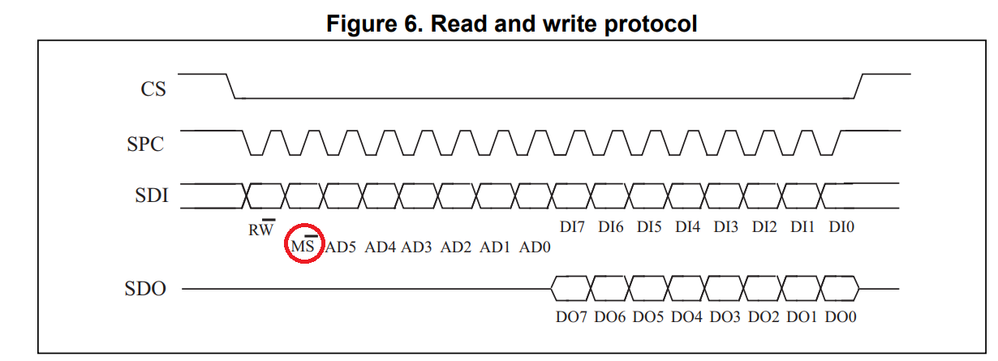

Are you in SPI Mode? If so, are you implementing the MS bit correctly during the reading protocol?
If you have doubts, please refer to datasheet page 20:
