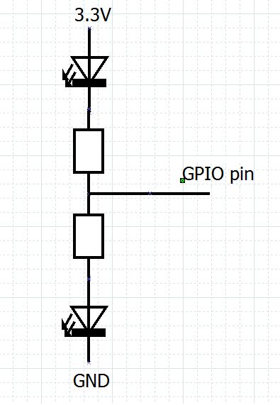

the GPIOs are configured as Push/Pull when in output mode.
As a confirmation, I have connected this simple circuit to all available GPIOs: the two LED are mutually exclusive lit, showing the GPIO can drive both directions.
This apply to GPIOs driven by OS and to GPIOs configured by console commands.
If this is not your case, could you please detail it more?
