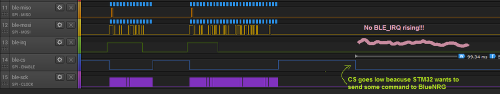

In my device I use BlueNRG-2 working as Network Processor (DTM firmware is loaded there).
It cooperates with STM32 where is my application. Processors communicates each other via SPI interface.It works fine for long time but suddenly BlueNRG-2 stops responding.
STM32 change BLE_CS pin to active state (low) but BlueNRG never rise BLE_IRQ.It may happen after half hour or couple of hours.

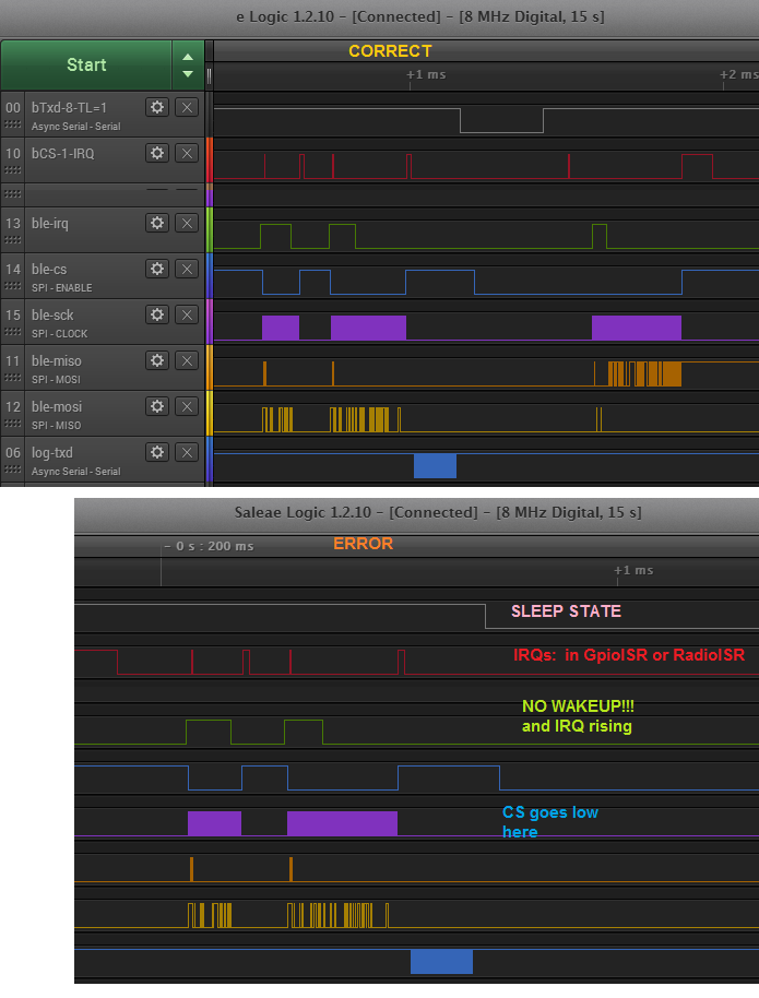

An update:
It seems that BlueNRG is not woken up when CS goes low (please compare recordings from logic analyser below).
May I ask someone from ST to have closer look at this case?
Is there any issue with waking up (an errata case)?Looks very serious.

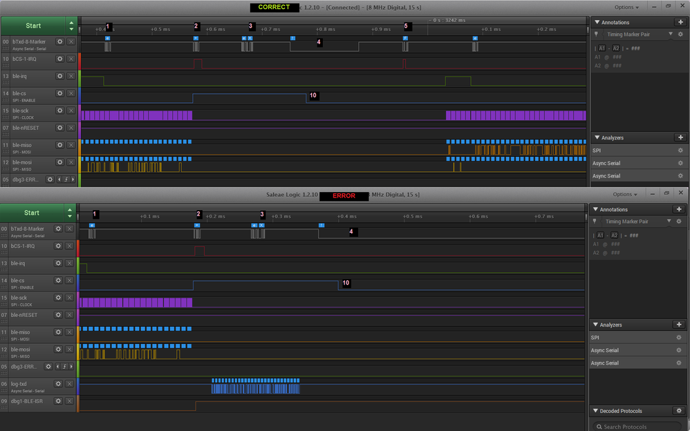

I have strong confirmation that BlueNRG-2 sometimes is not waking up from deep sleep state,
although the waking gpio pin goes low!
Below I describe verification method.
I put markers in a few places in the code (just sending one serial character):
So following sequences corresponds to execution of WFI:
On diagram deep sleep state can be also identified by low level on serial line (during deep sleep line is pulled down).
The source code is taken from ST Development Kit for BlueNRG, so I treat it as reference.
But anyway, the verified part is very simple: setting waking up pin and execution WFI.Why waking up is not working sometimes?Regards,
Piotr Romaniuk
PS
Below is comparison of two analogous communication and sleep down.
Legend:1-2 idle sleep
3 preparation to deep sleep
4 deep sleep
10 gpio waking pin goes low
5 marker for exit from deep sleep (end of function)

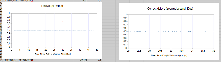

2018-05-14 2:22 PM
I measured statisticaly for different delays between entry into deep sleep and wakeup signal.
Problem appears only for 30us delay.
