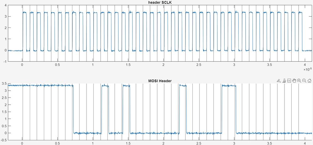

The problem I am having is that it seems like the packets I am receiving through SPI don't make sense completely and they seems to be a bit off. I have measured the SPI signals and the received header is {0xFF,0x09,0x01,0x06,0x00}. The measured signal is shown below together with the clock and the rising edges marked

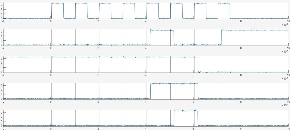

The data received after the header is {0x04, 0xFE, 0x06, 0x02, 0x00, 0x02}. The following image shows the first 4 measured outputs. The last two are all 0s and the same as the 4th.
The problem lies on the received parameters that don't pass the verify_packet() function inside hci_tl.c as it returns 2. Wrong length due to the third parameter's value being 6 and the actual data being 3 bytes long.
