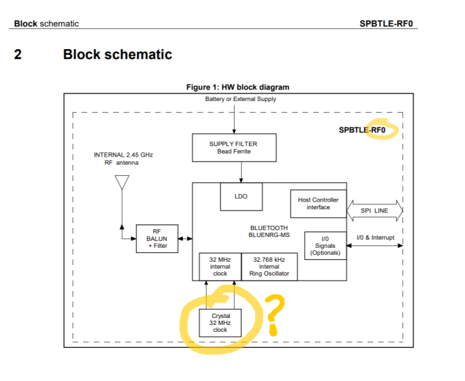

2018-06-28 5:29 AM
Thanks for the info.
Does that mean the datasheet is wrong...
2018-06-28 6:22 AM
Do not confuse BlueNRG's mandatory HSE (16, or 32MHz here) with optional LSE (32KHz)
2018-06-28 6:43 AM
Sorry, I immediately read it as 32Mhz, not Khz.
Thank you
