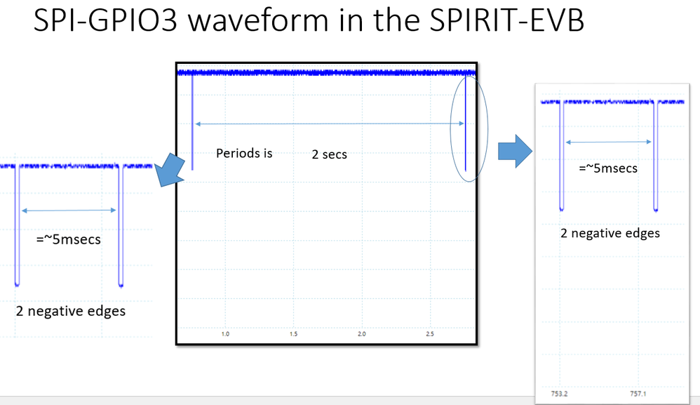

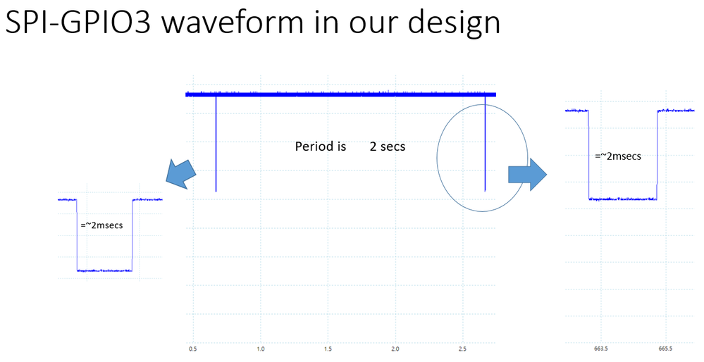

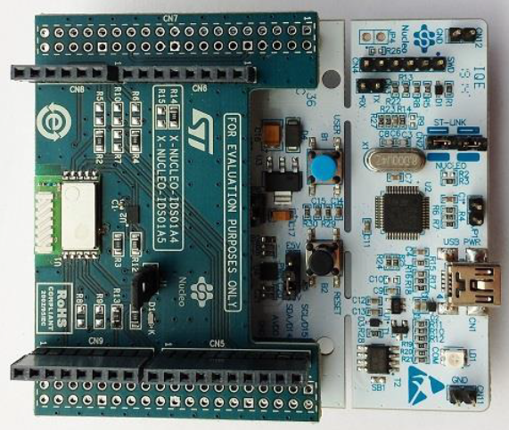

It can work on the P2P demo as the attached file. Now we design a similar circuit(STM32L152+SPIRIT1-868 ) baseon the EV Board and migrate the firmware of CubeExpansion_SUBG1_V3.0.0. Finally, we have some trouble in the RF transfer. The experiment result is as the follows. We can successfully send RF command from our design board to the EVB, but the EVB can only successfully send twice to our design Board. After initial the RF, we got the different waveform on SPI-GPIO3 between these two design. What is wrong?
