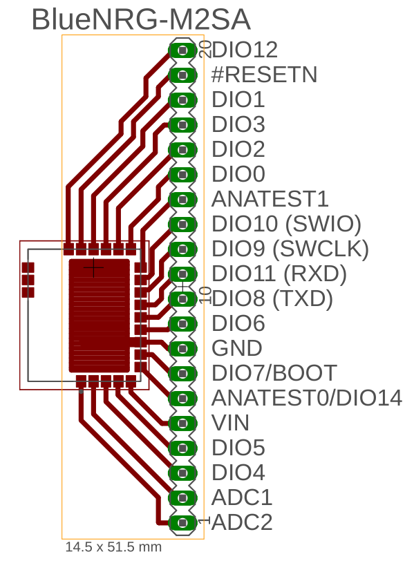

Hello, I would like to ask you for help with programming and debugging the BlueNRG-M2SA module.
I am just not able to get started and successfully connect to the module using ST-Link v2 over SWD. Neither using USB-UART chip (PL2303SA) to communicate with embedded bootloader.
I prepared this adaptor to DIP for the module to make it easier for breadboard tests:
When I try to connect to the target using BlueNRG-1 ST-Link Utility, after checking that VIN, GND, SWDIO, SWDCLK and #RESETN pins are connected correctly, I get this error messages in the trace.log file:

2020-01-12 9:48 AM
I managed to get ST-Link working. The problem was I was using cheap chinese USB ST-Link, which didn't communicate with the module for whatever reason. I tried embedded ST-Link in Nucleo-F303RE and STM32F4-Discovery kit, both are working.
But the bootloader over UART isn't working anyway.
