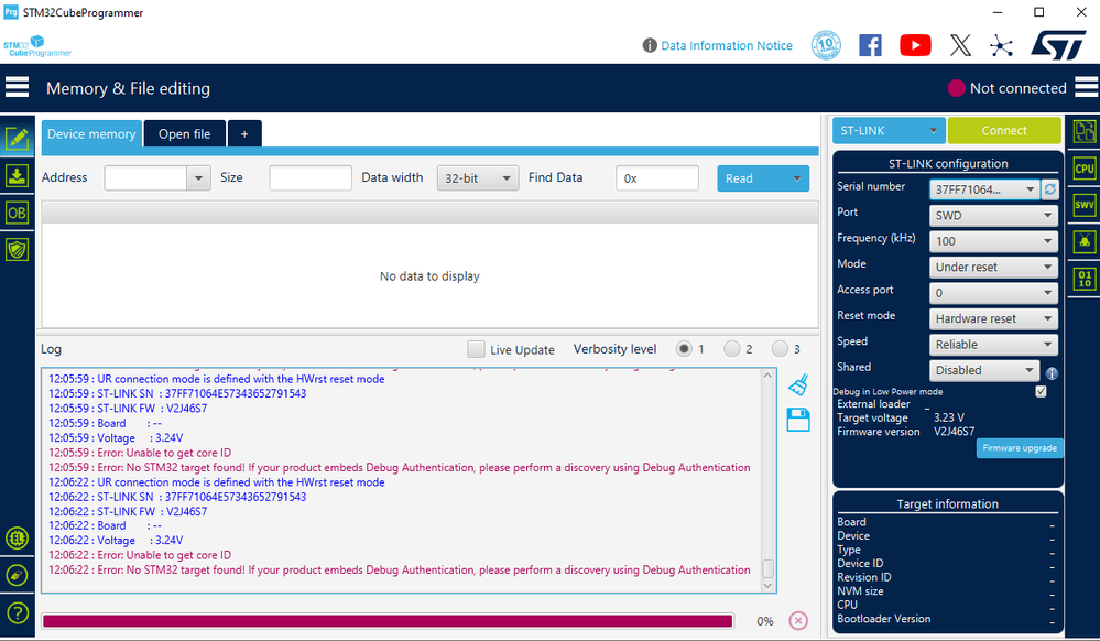

11:19:26 : ST-LINK SN : 37FF71064E57343652791543
11:19:26 : ST-LINK FW : V2J46S7
11:19:26 : Board : --
11:19:26 : Voltage : 3.24V
11:19:26 : Error: Unable to get core ID
11:19:26 : Error: No STM32 target found! If your product embeds Debug Authentication, please perform a discovery using Debug Authentication

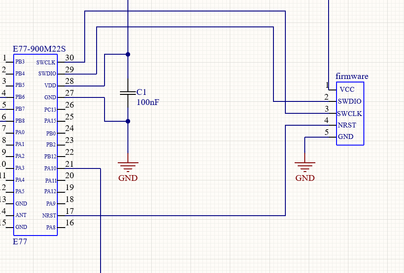

@AlexPCB wrote:I have connected SWDIO and SWCLK properly and the module has 3.24V so the problem its not the connections.
Please show your schematic for people to confirm.
A good, clear photo could also help.
You haven't mentioned VTARGET, GND, or NRST ... ?

This is the schematic of the connection:

To be clear, I have a clone ST-LINK but CubeProgrammer recognizes it and I can update its firmware perfectly just as seen in the image:
Even if it is recognized, does the problem "No STM32 target found" come from it being a clone?
2026-03-27 4:27 AM
Again, there is no guarantee that those will work properly (or at all) with ST's tools.
They are simply not supported.
You could try faffing around; you might get lucky - or you could just get a genuine ST-Link (or other genuine supported brand) and get on with your project ...
