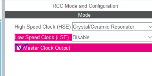

Maybe your XTAL pcb traces have huge capacitance or you placed the sligtly bigger than needed capacitors?(or youre using one of those RC resonators instead of a xtal)
You can figure out the real clock your chip is using by probing with an oscilloscope very fast PWMs or outputing master clock directly to a pin.
2021-08-26 1:49 AM
It may be the problem. My capacitors on the xtal lines are 30pF. I have chose this based on the load capacitance of my crystal.
