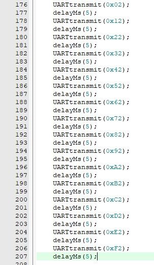

I'm trying to use uart1 in stm32f411ce and I have a weird problem. in my test I am sending data from the stm32 to an arduino and printing the received data on the serial monitor. In the stm32 I'm sending bytes with the most significant part counting from 0x02 to 0xF2. the list significant part always transmits well but the LSP has a weird behavior. I made a table that shows the transmitted bytes and the received bytes.

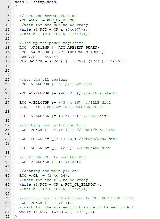

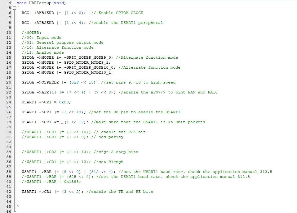

I'm using a custom board with an 8mhz crystal clocked to 96mhz. the usart1 bus runs on 48mhz. this is the uart and clock configuration code
2021-08-25 4:36 AM
is that autogenerated with cubemx?

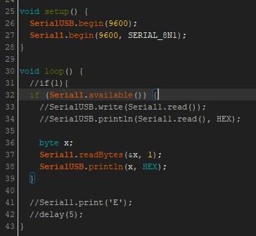

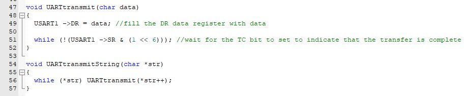

i meant show us where youre handling the RX and TX, also the arduino code
2021-08-25 4:59 AM
I have wrote it myself. here is the arduino and the TX code.
2021-08-25 6:19 AM
whats wrong with USART_SendData()?
also the while(!USART.... (active wait ) should be checked before the transmission attempt not after.
