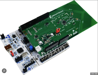

I'm trying to use a SX1280 for RF connectivity.
My dev board is the official... the SEMTECH "SX1280ED1ZHP", it's included a nucleo + daughter board with SX1280.

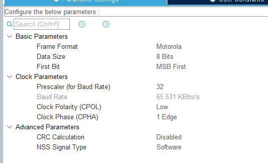

#IOC Spi configuration

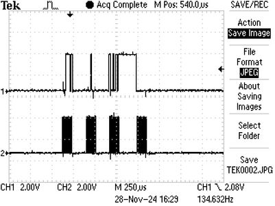

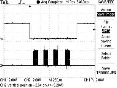

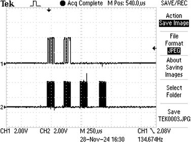

Channel 1 : CS / Channel 2 : SCK
Channel 1 : MOSI / Channel 2 : SCK
Channel 1 : MISO / Channel 2 : SCK
