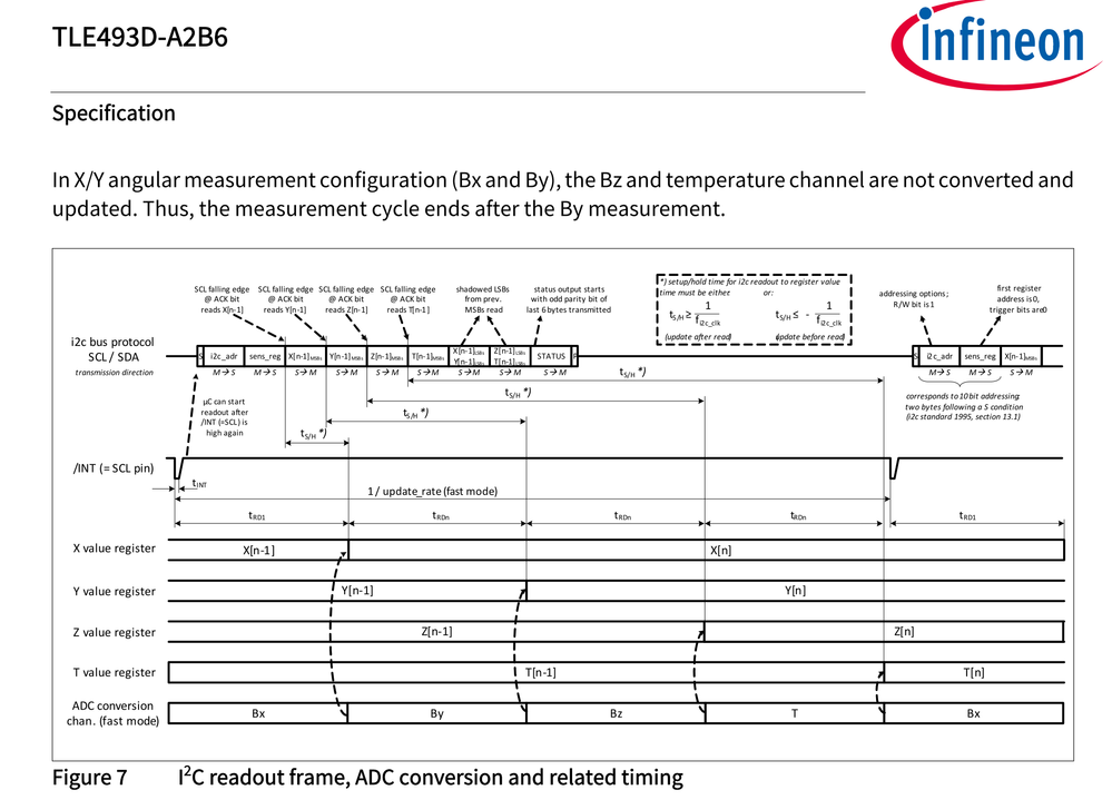

Here I am again. My code works now :D
As described in the data sheet, the I2C communication can only start after the SCL interrupt, driven by the slave, is over. I currently fixed this issue by starting the first read command after I receive an interrupt on the SCL line. After that, I disable the INT bit in the register 0x11. With this setting, I can receive data with the following command:

Unfortunately, I still did not figure out what exactly the error is. I managed to communicate with my sensor over I2C with an Arduino UNO board. Whilst using my ST Board, I observed that my sensor is pulling down the SCL line periodical. When I disconnect the SCL line to the sensor it, everything is fine, except the ACK is not sent, because my sensor has obviously no CLK.
