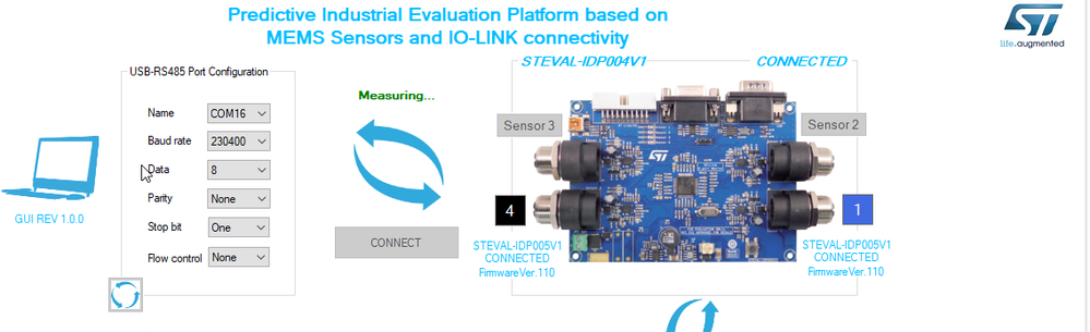

Finally I was able to successfully get the data on the STEVAL-IDP005V1 GUI.
And for me it worked through serendipity!
Graphs and other readings are being displayed..
It seems the STEVAL-IDP004V1 board needs both the ST Link AND the RS485 to be connected simultaneously to be able to make the connection.
I left the programmer link connected unintentionally and then attempted to connect via the USB serial and it successfully connected.
Disconnecting either of the two causes the connectivity to break

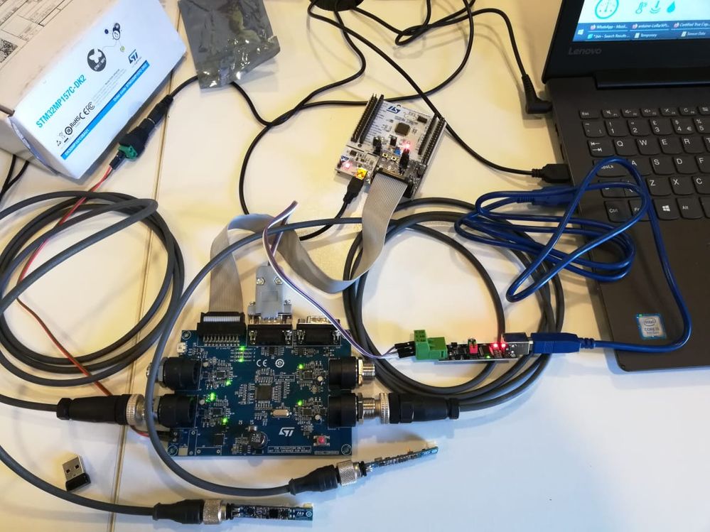

The blue cable is the USB-RS485 cable connected to the IDP004V1 on its RS485 port.
The Programmer link is connected via the ST-Link port on the IDP004V1 and the UK1001V1 interface board supplied with the STEVAL-BFA001V1B kit.
Both are separate Com ports.
The IDP004V1 IOLink board is programmed with the STEVAL-IDP004V1_RS485.hex using the Nucleo Programmer and the UK1001V1 board. A 20pin flat cable is used to link the two IDC type male headers.
So whats confusing is that all the manuals say that after programming, the programmer should be disconnected. However if it is not connected then the GUI fails to connect to the IO link board.
Once I connect via the USB Serial with programmer connected in parallel, removal of the programmer link causes failure of communication.
I am quite sure that the data is flowing through the USB-RS485 link because it is the one showing TX/RX activity through the indicator LEDs and the com port selected in the STEVAL GUI also corresponds to it.
So whats going on?
