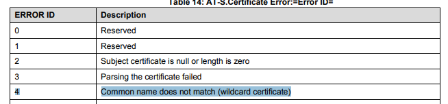

AT-S.Certificate Error:4

Certificate error #4 corresponds to :

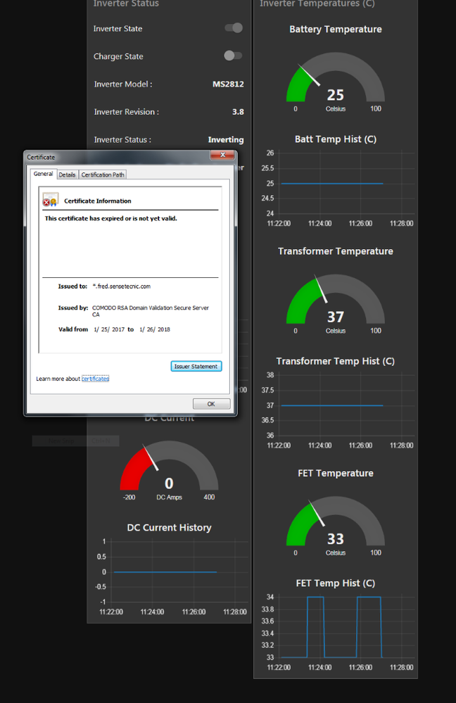

It appears that the common name has a wildcard in it…I wonder if that might be what is going on! Not sure how to get around this...I have attached the CA cert for *.sensetecnic
I also get bizarre error messages in the Google Chrome. On my home laptop I do not see these issues...

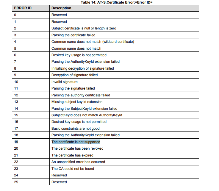

AT+S.HTTPPOST=dreamsmatrix.fred.sensetecnic.com,/api/public/sensata/wifi?Data=12345,443,2,,,,
AT-S.Certificate Error:19
AT-S.Http Client Error:2
AT-S.ERROR:111:Request failed
Why would the certificate be unsupported ?!

I have tried the lastest FOTA and same results on ignored FRED cloud server cert! This is starting to look bad in the sense that wildcard certificates do not seem to be supported ??? This kinda hangs me out to dry if I cannot use the server cert! It looks to me like the server cert from sensetecnic.com is automatically blocked...I need a firm answer on this issue...Amazon works on .PEM and .DER certs on TLS, but the sensetecnic wildcard cert does not, regardless of what it do...It is cut and dry rejected! What's the workaround ?

wildcard certificate are actually supported.
The Certificate Error:4 was issued because the server domain name check against the CN in server certificate was failing (the server name must match the common name specified in the certificate).
On the other hand, the signature in both 'COMODO RSA Domain Validation Secure Server CA' and 'COMODO RSA Certification Authority' (sha384WithRSAEncryption) is not supported. The support for this signature will be available in the next SPWF04 firmware.
