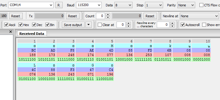

First, when I 'Flash & Run' the BlueNRG-1 Hello World from the basic examples I get this output:
With another terminal program it looks like this:
I expected Hello World... What's wrong?

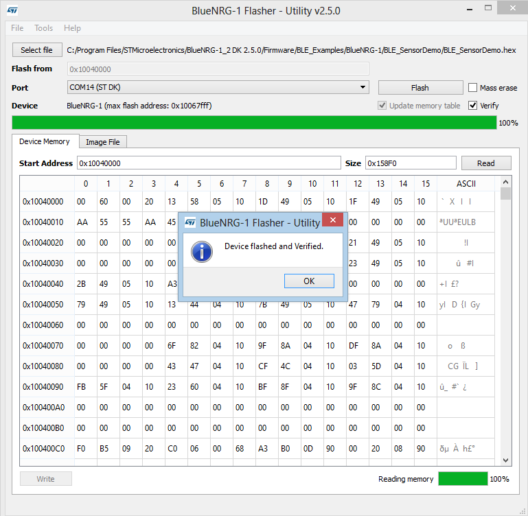

thank you for your fast answer. I already used 'Flash & Run' in 'BlueNRG-1 Navigator' to flash the BLE_SensorDemo. The LED DL1 is flickering a little bit but I got no BLE Connection with my smartphone (Samsung Galaxy S7) and with three different apps from different suppliers: BlueNRG, nRF Connect and BLE Scanner.To make sure BLE on my smartphone works as it should I used a BLE HRM belt which was recognized by all three apps.
With your answer I used the 'BlueNRG-1 Flasher' utility to flash the Firmware\BLE_Examples\BlueNRG-1\BLE_SensorDemo.hex file again. Same behaviour: DL1 is flickering but no BLE connection to any of the three apps (BLE HRM belt works fine)...
This is a screenshot after flashing BLE_SensorDemo.hex:
Do you have any further ideas what I could do?

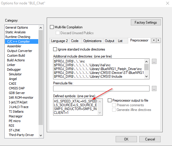

2018-06-07 4:34 AM
Hi Mitja,
after reading another message of yours in another thread, I understood that you were referring to preprocessor define for the crystal, i.e.
HS_SPEED_XTAL=HS_SPEED_XTAL_32MHZ
.If you're using IAR Embedded Workbench, from the menu select 'Project > Options...' and then you can define it in the 'Preprocessor' tab of the C/C++ Compiler section, as shown in the picture below.
Best regards,
Antonio
2018-06-07 4:44 AM
Thank you for a fast response! It worked like a charm!
Regards,
Mitja

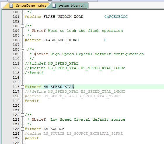

2019-01-03 9:21 PM
Hi Aontonio,
i am using the EVAL-IDB007V1M board and Keil V5.
as per your previous discussion ,i change 32 Mhz and it works for "hello World" example.
here, i modify "system_bluenrg.h" file.
But BLE programs are loaded to EVAL-IDB007V1M board but the BLE Android applications not detect.
kindly give the solution...
