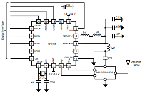

BALF-SPI-01D3 has 2* L and 3* C connecting to SMPS Ext1 while
BALF-SPI2-01D3has 1* L and 1* C connecting to SMPS.
This is schematic for BALF-SPI-01D3:

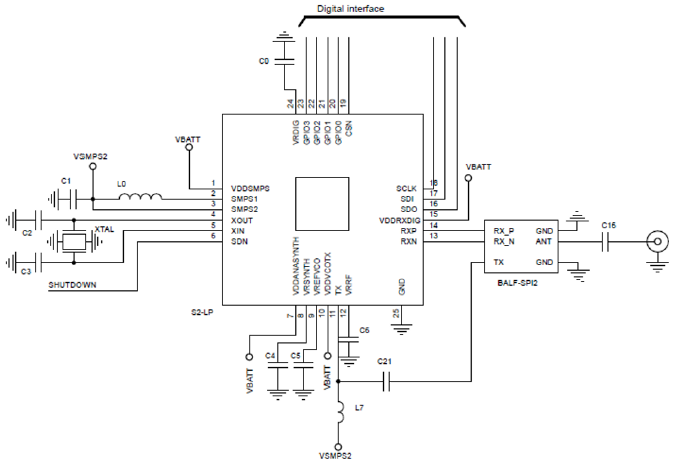

And this is the schematic for BALF-SPI2-01D3:

Have you double checked that TX-line between S2 and BALUN is connected to SMPS2 as seen on p.5 here (VSMPS2):
Did using discrete components instead of balun help?
2018-04-12 9:04 PM
Hi Anton,
Thanks for your thoughts and suggestion! Yes I am following exactly the same schematic - the one in the updated version of balun reference manual. I have actually compared the voltages between the S2LP Eval board and my board and they are similar. The one with discrete components also behaves similarly, get a very flat output and not a nice spike @868Mhz on spectrum analyzer. Both the versions are two layer pcbs and also I did not follow exactly the transmission tracks length guidelines, I was following the older version. But after that test, I have designed 4 layer pcb and have taken all possible care to follow the guidelines. My samples boards should arrive in couple of days. I am very much hiopeful this time Will soon post the results!
Best regards
Silas
