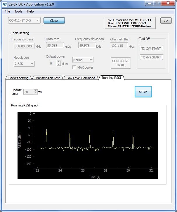

Hi
I did some redesign of the custom RF board, all capacitors in 0402 package, also using the
BALF-SPI2-01D3 balun for 868Mhz.
Now I have a different issue. With my custom microcontroller board, when I connect the
STEVAL-FKI868V1 board using SCL, SDI, SDO, SDN, CS and GPIO3, the board transmitts fine (I am using Basic_Generic_A TX code) and on my other STEVAL-FKI868V1 kit (with nucleo) it receives fine and decodes the payload perfectly. But when I just replace STEVAL-FKI868V1 board with my custom RF board with my microcontroller board, I see that it transmits the signal but on the receiver STEVAL-FKI868V1 kit, it does not decode. I have attached the pic of RSSI with this. All other conditions remain the same (same modulation, data rate, bandwidth etc).Where should I look? The balun could be the reason? Seems all the components are soldered as expected. Any help or suggestion?
Thanks
Silas

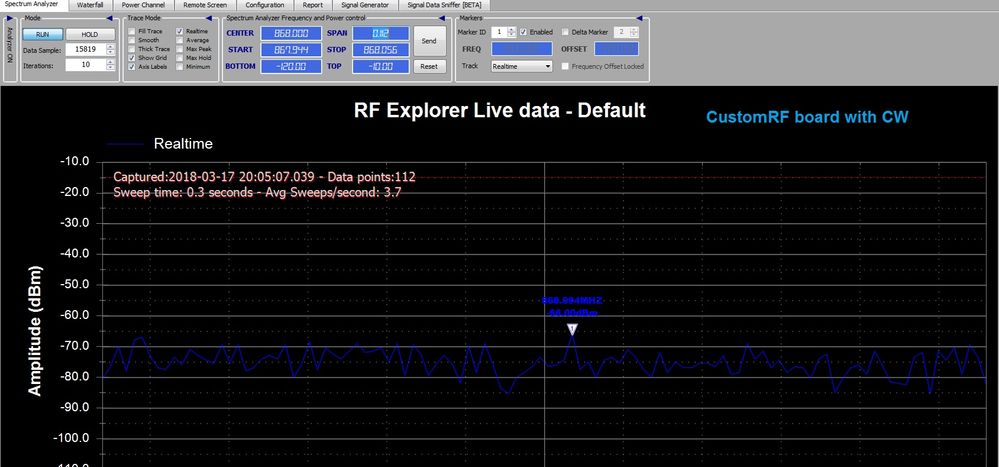

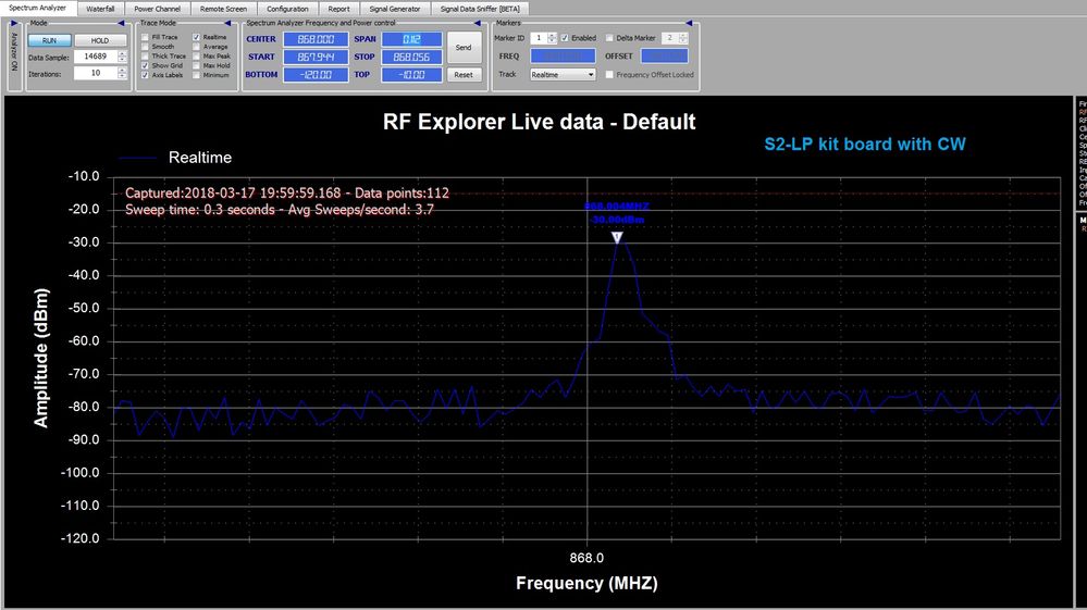

Hi Igor,
Here is some more findings after I did some more test using CW mode
Coded for CW mode (no modulation) : Running the code for CW with S2-LP kit board with my controller board - and looking at the spectrum analyzer - it shows nice peak of -30dBm at 868Mhz, I have included the pic below. And then replacing the kit board with my custom RF board, I see no such peak for 868Mhz, but kind of spread, seems lot of harmonics, also included the pic below
Can this behavior be because of the balun
BALF-SPI2-01D3 mismatch? Seems like there is no selectivity for the 868Mhz. Can anyone help on this please? Should I update my design to use the discrete components instead of the balun? The only benefit of using the balun is reduced component count and smaller PCB. I would really appreciate any of your feedback..
Thanks
Silas

Hi Silas,
BALF-SPI2-01D3 is designed to match S2-LP 868MHz and 915MHz.
Some thoughts but i am not sure how much i can help:
Could you dump all the registers to doubly check if the custom RF board is configured exactly the same as EVAL board?
Is it possible to replace the receiver device (instead of the transmitting one) to your custom RF board?
Just to see if the custom RF board can receive well then the TX circuit will need to be checked.
Maybe it will be better to provide schematics and the board for some local FAE's reviewing.
