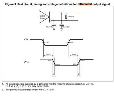

Hello, I measure the output differential voltage of the drivers (with 100ohm termination resistor) and it is always higher than 0.4V that is referred to the datasheet. What I measure is about 0.68V. Is that normal?

Is this the test circuit you have used.
The datasheet values are according to this test circuit.

Hello @DMala.1

Hello and thanks for the answers!
The chip is supplied with 3.3V and I measure on a termination resistor of 100Ohm as in picture 3 of the datasheet, what I don't use is the two capacitors.
2023-09-14 12:44 AM
To have a credible result, you should use the same conditions as described in the datasheet (you should use the 2 capacitors).
