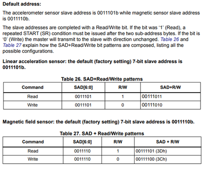

I have a STEVAL-MKI173V1 which is for the LSM303AH.
I have to integrate this on a project in VS code, as there is no Zephyr driver for this, I am trying to implement this directly on I2C.
The device has two addresses one for the accel and the other for the magn, the supplied addresses
/** I2C Device Address 8 bit format **/
#define LSM303AH_I2C_ADD_XL       0x3B
#define LSM303AH_I2C_ADD_MG       0x3D
does not respond when a "device is ready" check is done, I don't see any other addresses in the datasheet.
I got these from the header file, supplied under HAL
I must be missing something, I have tested other I2C devices on the same port and it works just fine.

Hello @Samuel Schalkwyk ,
Could you please check this section in the datasheet : https://www.st.com/resource/en/datasheet/lsm303ah.pdf
Foued
