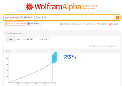

The problem is the logarithmic nature of how I'm deriving degrees. I am taking arcsin of g to get radians, and then multiplying by 180/pi ( 57.3 ). After 75 degrees, the output becomes more dramatic, and every mg of error heavily impacts the accuracy of the reading:

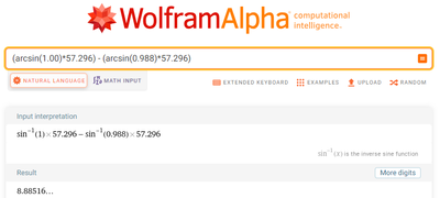

I will look into this 12mg error part, but even at 90 degrees, we are now talking about a potential error of 8-9 degrees:

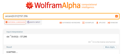

Furthermore, you are saying your margin of error on your 12mg part is 0.2 degrees, but according to the math we are using, your error should be +/-  0.7 degrees:
