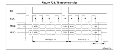

ie on H563 u could use TI mode : (if this is, what you want)
SS = CS output
