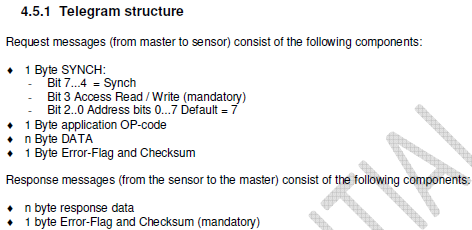

I have a Pepper+Fuchs sensor which interface is LIN(attachements are datasheet & user manual ). I need to test the sensor by computer so I purchased RS232 to LIN converter. I send
handshake command on computer to the converter and it respone telegram correctly. The telegram format of converter is as below:
While
telegram format of Pepper+Fuchs sensor is as below. When i send telegram following below to the sensor, there is no respone at all. Due to the 2 type telegram format is different , i don't know where is the problem. Is there anyone can help me?

Hello ,
this component is using 'Interface Interface type Physical LIN interface Transfer rate 19.2 kBit/s (8N1) Cycle time 100 ms'
i do not think that it is a ST device.
i recommend you to contact Pepper Fuchs community website
Best regards
