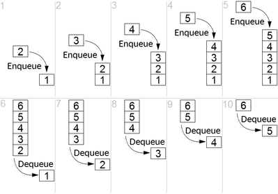

The CH1_CR1 (and CH2_CR1) register also has synchronous and asynchronous operation mode. In asynchronous mode, the data buffer operates in FIFO mode (When a slot is read/cleaned, it becomes available for other data to be received). So it has two interrupt modes per full data buffer (it has two ways to fill the data in the data buffer):
https://en.wikipedia.org/wiki/FIFO_(computing_and_electronics)
