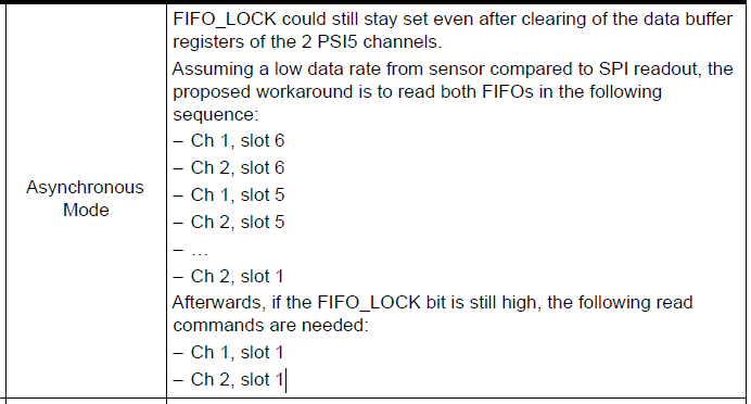

The manual isn't clear on this. It also says the sensor buffer is a FIFO in Asynchronous mode, but it really isn't. "FIFO" means "First In, First Out", and every other FIFO I've ever seen in the world lets you read the data from one location, and the data shifts down as you read it. What we have here is a half-FIFO. It is a FIFO from the chip's side. It pushes data in starting at the first slot, and the data pushes down. But you can't read it from the other end. It also can't "fill from one end while you're emptying it from the other end", which is the usual point of a FIFO.
With this one, the first SIX words push in from Slot 1. When it is full you get an interrupt. You then have to read it starting from Slot 6 going down to Slot 1. On the first read the FIFO "locks" (whatever that means). Only when all the buffers have been emptied does it "unlock" and start storing data again.
The above description sounds like there would be a "race condition" if things didn't happen in the right order, and sure enough, you had better read the Errata to see what can go wrong. It also tells you there that on the interrupt to read slots 6, 5, 4, 3, 2, 1, and then check the FIFO_LOCK bit. If that is still set you read Slot 1 again. If you write some test code you'll probably find that "failing to unlock" doesn't happen, but don't leave the code out. This sort of thing might only happen once an hour or once a day. But it would lock the whole thing up if you don't have the recovery code there.
It is worse than that. There are two channels, and so there are two FIFOs, and I'd expect to see two FIFO_LCK bits in the registers, one for each FIFO. But there's only one "FIFO_LOCK" (also called "FIFO_LCK") bit. So do BOTH FIFOs lock when you read one of them, or are there two internal FIFO_LCK bits that are OR-ed together and the register bit only shows if either is set? I have no idea. But the Errata implies that when one FIFO fills you had better read BOTH of them. Maybe that only matters if you have both channels running, or maybe it doesn't. If you are using both channels in Async mode you get two separate interrupts, but only one FIFO_LCK bit.
If you're using both channels you had better read both like it says in the Errata. If you're only using one then you'd better write some test code.
You might also get a "Buffer Empty Fault" when doing this, so be sure to check for that and to have recovery code for that as well.

As it is mentioned in data sheet, the contents of UDB1 determine the SYNC pulse length and it doesn't contains the sensor data. In asynchronous mode sensor data registers are working as a FIFO buffer with 6 stage.
So in order to read the sensor data in asynchronous mode you need to read the sensor data registers through SPI frame as shown in Figure 29 (page 86).
Please pay attention that SPI communication is out of frame, so you need to send 2 times the read SPI frame. the received MISO of second frame will be the sensor data you expect to read.
also consider the following procedure for reading sensor data:
