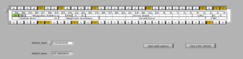

The reason this is so confusing is that there are three different ways to calculate CRCs in software. There's the "Augmented Method" where the data has to have zero bits appended. That version derives directly from the basic theory of CRC generation, so it is the version given in educational material showing the derivation.
It is possible to rearrange the "software shift register" so that the "appending" can be skipped. This gives the "Direct Method". As it is more efficient, that's the way most people do it, and how most sample code is written.
So the "Direct Method" can be implemented on 31:5 or the "Augmented Method" can be implemented on "31:5 plus three zeros". Searching for code examples turns up a lot of "Direct" examples, without any explanation that they're different to the other method, which is the one assumed in the L9663 Manual.
The next problem is that ST's routine requires an "Initializer" of "7". Using "Direct Method" code with "7" gives the wrong result. For "Direct", the value "2" has to be used instead.
I said there were three methods. The most common is the "Table Driven" one that operates 8 bits at a time on large amounts of data. That's the most common example code out there, but you can't use one of them on 27 BITS of data.
The image you've included in your reply seems to be of a software tool that calculates the CRC and other parameters. Is that available for developers?
