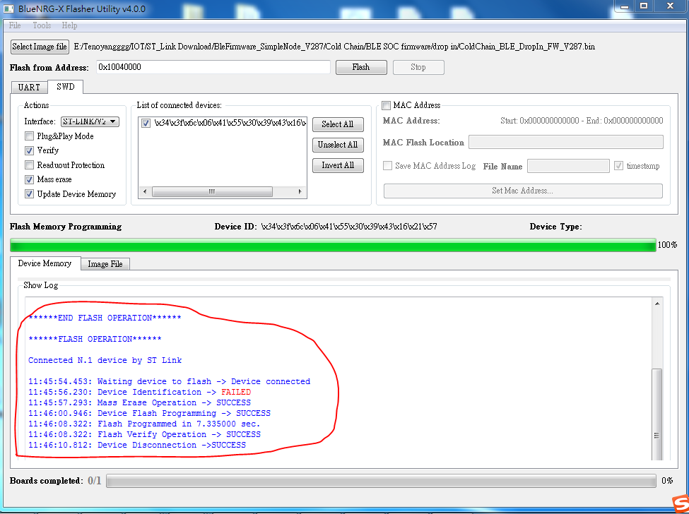

I can use BlueNRG-X_Flasher_GUI.exe to program the target chip,please see attached
picture 1.

Q:How to use BlueNRG-X_Flasher_GUI.exe to download a Hex file to the target chip (BlueNRG-LP QFN48)???
