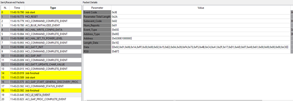

The following screenshot would be a test on GUI for ACI_GAP_START_GENERAL_DISCOVERY_PROC(), with some LE advertising report event containing UUID information.
Subevent_Code = 0x02 (HCI_LE_ADVERTISING_REPORT_EVENT)
Event_Type = 0x03 (ADV_NONCONN_IND)
RSSI = 0xB7
Data = [[0x02,0x01,0x06,0x1A,0xFF,0x30,0x00,0x02,0x15,0xE2,0x0A,0x39,0xF4,0x73,0xF5,0x4B,0xC4,0xA1,0x2F,0x17,0xD1,0xAD,0x07,0xA9,0x61,0x00,0x00,0x00,0x00,0xC8]]
The data contains iBeacon data with UUID equal to ST:
