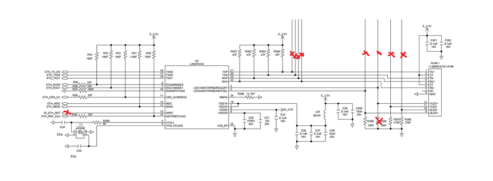

Sorry, my description is not clear,
the PCB is a layout by myself,
here are my schematics below,
red X is not used,
now I test result is, RJ45 plug/unplug LED shows normal�?DHCP get successfully, and I use MQTT send/ receive normal,
but the temperature will rise(~50 degrees) after plugging RJ45,
I have no idea what problem is.

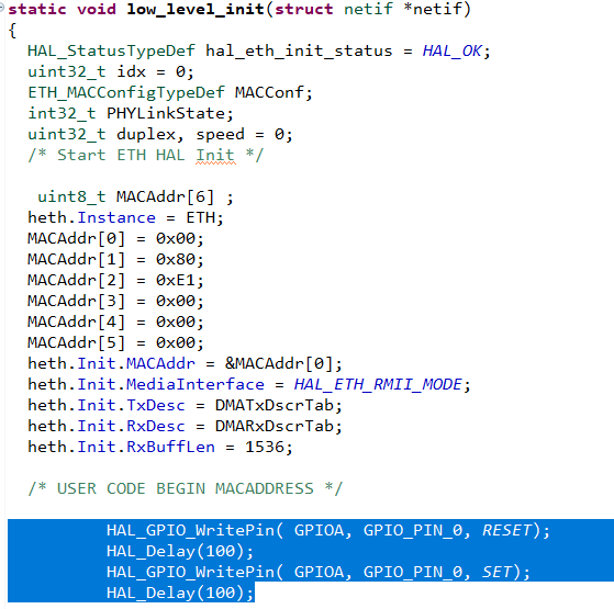

and I have another problem, NRST is necessary to set IO in stm32 MX or not?
if I set IO output, I reset(section of USER CODE ) when restarting is correct?
Either you just connect it to the NRST of MCU, or connect it to some GPIO and do a reset with a software. Unless you have some special requirement of PHY chip NOT being reset, when the MCU is reset, connecting PHY NRST to MCU NRST is easier to manage and does not require an additional GPIO pin.

I test a week, the temperature �? NRST software reset is well,
