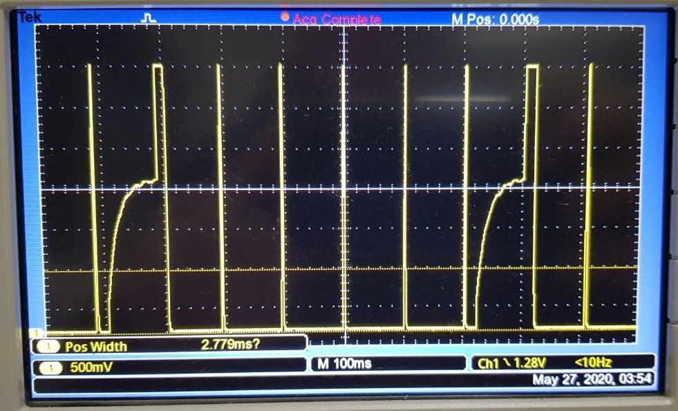

1) Fist image I use the internal LS crystal setup (LS_SOURCE_INTERNAL_RO):
Note that almost 80% of the time the low power mode is successfully achieved.
There is something waking the SoC and hold for a long period until start advertising, and it happens some times.

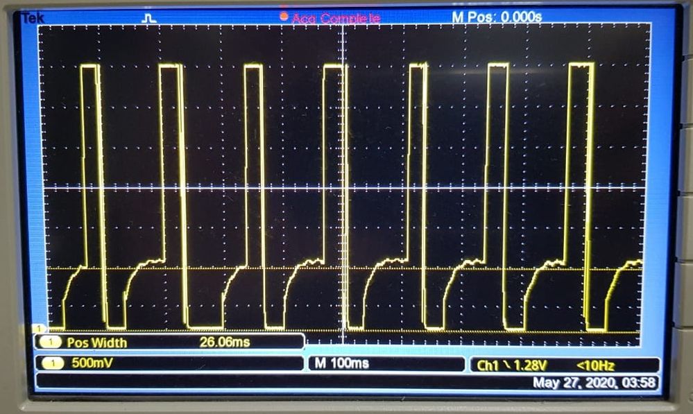

2) The next image I used the external LS crystal (LS_SOURCE_EXTERNAL_32KHZ):
Using the external crystal, the bluenrg never achieve full low power completely.
There is something waking the SoC and hold for a long period until start advertising. It will kill my battery.
Another difference with previous scenario is the long period transmitting.
According to software "BlueNRG Current Estimation Tool", the transmission time is 2.5ms. It not happen here.
