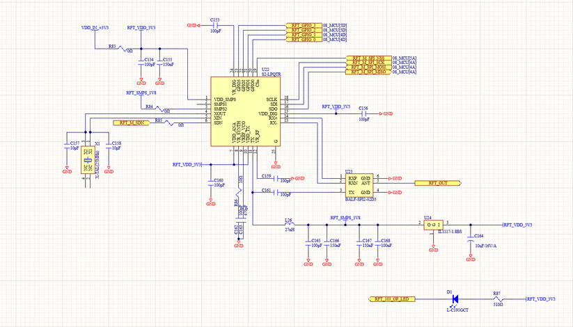

Hello everyone,
I’m trying to control an S2-LP QTR via SPI1 on an STM32F103VCT.
I completed the initial setup and configured the radio to 420 MHz.
I then wrote a routine to transmit periodically, but I’m not seeing any RF output on the antenna pin.
Below is the code I’m using for the S2-LP QTR. Any ideas what might be going wrong?

Schematic is below
I would appreciate it if you could let me know which parts might be incorrect.
