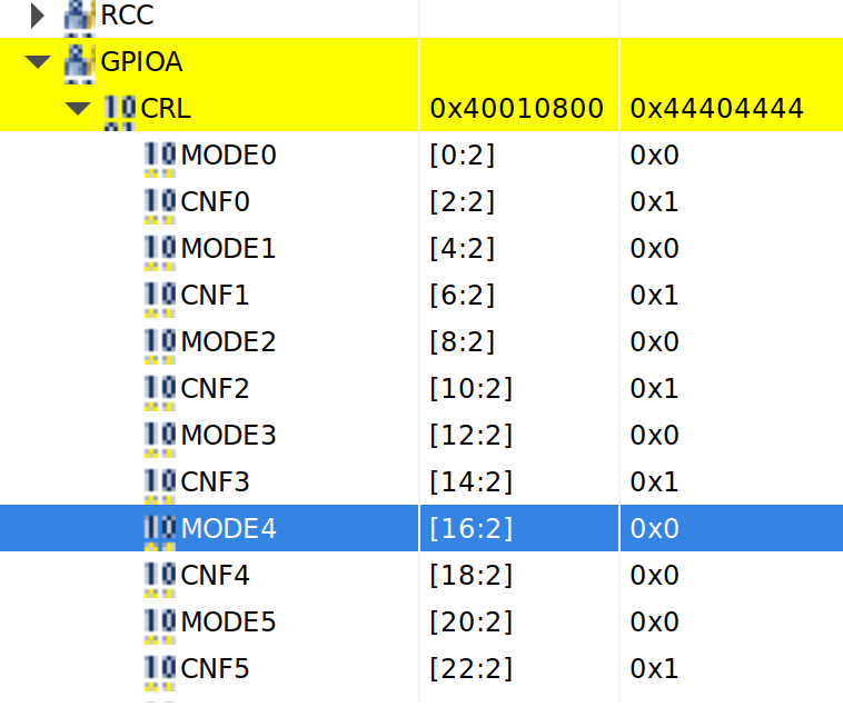

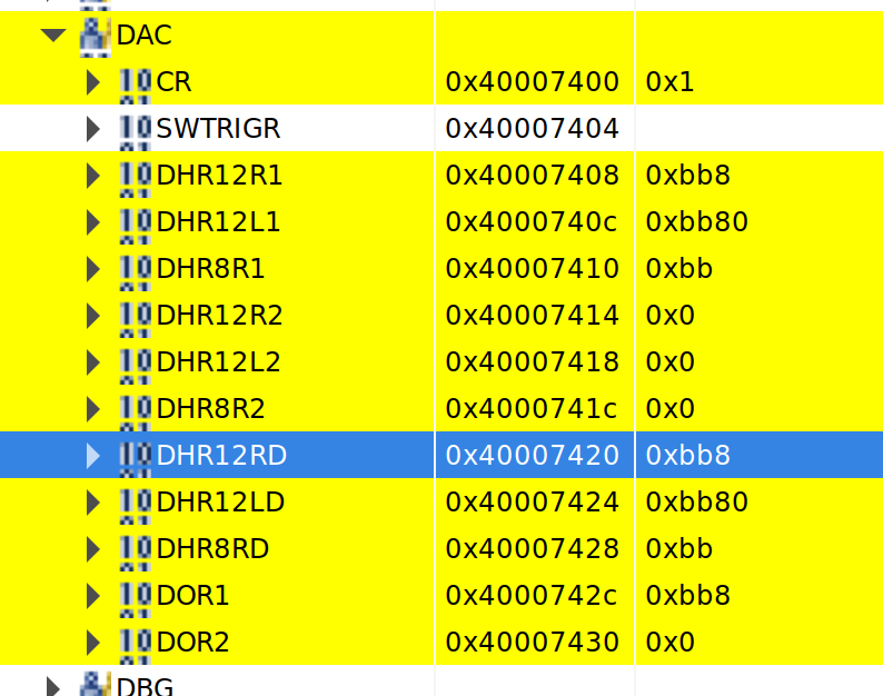

Read out and check/post content of DAC and relevant GPIO registers.
Note, that DAC output is of relatively high impedance so PA4 is heavily loaded externally, it won't be able to drive that pin adequately.

Thx for your answers, The output buffer is enable and the load connected to the pin is 10K.
The VDDA pin is to 3.3V. You can see that 3000 ==> 0xbb8 is in the dac register. But 0V on pin pa4. Why ???

Registers look OK.
Have you measured directly on the PIN? Try setting PA4 as GPIO Out and toggle in program while measuring.

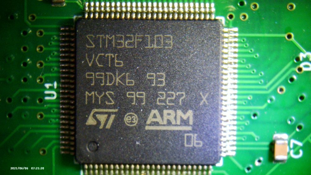

Is this a genuine ST part? Isn't it a counterfeit one? You can check on some of the "known good" boards like Nucleo or Disco.
2022-11-15 5:20 AM
MX_DAC_Init(); does HAL_DAC_Init and HAL_DAC_ConfigChannel, I shift HAL_DAC_SetValue and HAL_DAC_Start to have the same order as you wrote. But the same result, 0V to the pin.
I tried to toggle the GPIO register on debugging, It works, as output I had 3.3V or 0V depending ODR register, but when I reconfigured the registers to input pin I found the same 0V.

Here is the MCU I use, soldered by jlc pcb. May be you wright, this chip and the others I received are fake. Any one can confirm me that is (or not) a ST part ?
2022-11-18 7:51 PM
Those pins must be in analog mode.
And VDDA/VSSA and VREF+/VREF- must be supplied with the proper voltages.
