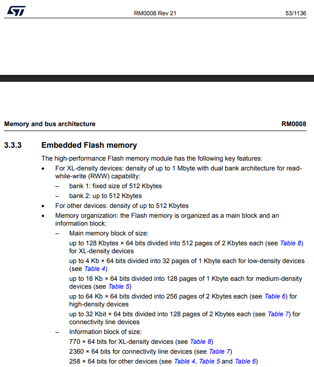

CubeIDE should only erase enough flash for the code:
Please give more details of how you are allocating Flash to the EEPROM emulation - it needs to be in separate pages from the code.
PS:
via: https://www.st.com/en/microcontrollers-microprocessors/stm32f103vc.html#documentation

You still haven't shown where you set the location of your emulated EEPROM within the Flash.
Also, how much of the Flash is used by your code?
Are you using the correct EEPROM Emulation library?
You need AN2594 for STM32F1 - not X-CUBE-EEPROM:
