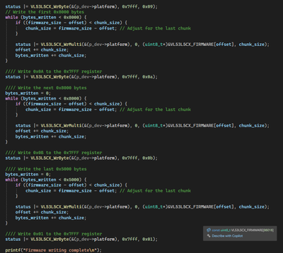

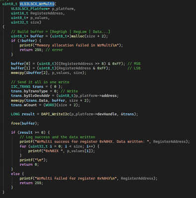

2025-09-30 1:23 AM - edited 2025-09-30 1:45 AM
below is when i split the firmware into small chunk 16 bytes i am able to write
Please check if these two are correct to write the firmware
