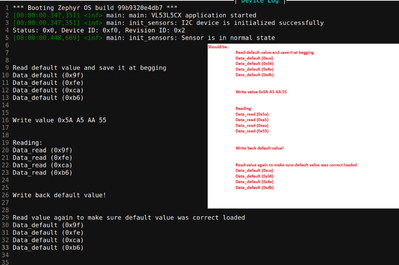

I have been struggling to work with VL53L5CX on my NRF board using Zephyr. I used the VL53L5CX_ULD_driver_2.0.1 API and changed the platform.cpp. So far, what my problem is as follows:
  • Failed on the vl53l5cx_init, because after the firmware is successfully flashed the  _vl53l5cx_poll_for_answer always gets the wrong value as attached image

Thanks for informing. I appreciate your suggestion to check the data integrity. Is this the code for testing the data endianness that you wrote is in this link
https://community.st.com/t5/imaging-sensors/vl53l5cx-driver-vl53l5cx-init-fails/m-p/640829/highlight/true#M3626 ?
I have tested using that, and as you can see from my attached image, the data was wrong. For example, first data should be 0xCE, but read as 0x9F and so on. I have checked my WriteMultipleBytes using a logic analyzer and has correct dataframe.
Indeed, the data reading is wrong, but, strangely, the API can be used for uploading the FW to the sensor. However, after being FW successfully flashed, then reset and boot up again, and when entering the NVM reading sensor, it always failed and recognised as timeout.
Do you think the problem could be FW upload failure due to MCU's incapability for transferring a large amount of FW data?
