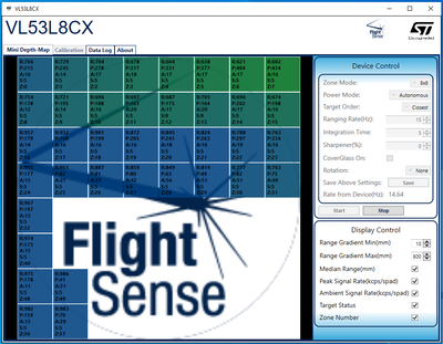

i also noticed that sometimes the "VL53L8CX_GUI" shows not all measurements:
As you can see where the LOGO "Flight Sense" is shown there are no measured pixels. I think the GUI software somehow evaluates which pixels have high confidence and which have little confidence. What is driving the decision? I think i would be fine if i could just use the same values as this example software.
2024-02-26 7:29 AM
When the sensor does not return a 5, a 6 or a 9 as status, the PC software does not plot it.
How to tell?
Use the logging feature. Turn logging on. Record a few frames, and stop the sensor.
There are two ways to look at the data.
If you simply click on the log file (you get there by clicking on the Log tab) you will open a log analysis window. It's pretty cool and you should try it.
You can also open the file with windows Excel. That way you can search through the data. There is one line for each zone and a header 'zone'.
You really should dig into the data.
- john
