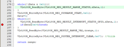

2024-02-26 11:22 PM
hi:
I am also stuck in the following function. Reading other registers that have already been written is normal, but it cannot be done after starting the conversion. VDD is using 2.8V and has replaced many settings, but it does not work. I don't know where else to pay attention to, please advise.
