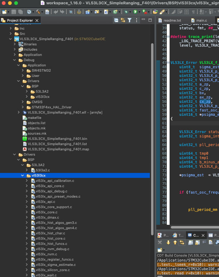

Thanks again sir. I managed to compile the driver, but now not sure how to use it. Forgive me for asking what may seem straightforward but i've never used STM32CubeIDE I'm just used to just installing existing python dependencies for modules on the RPi. In any case, please see image below of the project structure after compilation of that example project. Thanks.
2024-09-05 12:00 PM
This will be the blind leading the blind. I'm really experienced with CubeIDE, but not on a RPi.
Let's back up a bit. The STM32CubeIDE is based on the Linux Eclipse IDE. We pre-loaded it to talk to the STM32 debug processor on our boards.
But if you have the Eclipse IDE running on your RPi, I see no reason it should not work.
What happens when you hit the green '>' icon?
It's just to the right of the 'debug' icon that looks like a bug.
It's a good IDE, but it's written in python, so it's not really fast. But you don't need fast.
Hit the debug, the screen will change to a debug view. You get a 'skip-over' icon, that will run the next line and skip one down. The 'jump Into' will enter a function. With only these two, you can follow the code.
Dwell over the status return and look for anything non-zero.
See how far you get.
The output in my system goes to a serial port, so I'm expecting your will too. You just have to figure out where that serial port writes too.
Have fun.
- john
