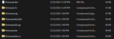

2023-12-23 3:15 AM
Thanks for your replies,
I have tested emCompress tool and here are the results:
emCompress-ToGo Compression Utility V3.32a compiled Jun 7 2022 14:50:43
Copyright (c) 2015-2019 SEGGER Microcontroller GmbH www.segger.com
Statistics:
Original: 86016 bytes
Compressed: 72630 bytes, or 84.44% of original
Saving: 13386 bytes, or 15.56% of original
Standardized: 6.76 bits/byteSo basically it went down from 84KB to 70.9KB.
I have also tested 7zip on Windows and got better results, around 60KB (not sure about the complexity to be decompressed on an STM)
